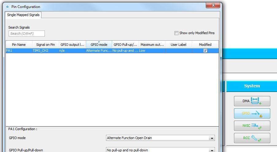

Hi klymenko.sergii,
I have made a test and everything is fine : I configured PA1 as TIM5_CH2 and picked GPIO mode as ''Alternate function Open Drain'' ( as you see in Figure bellow; mcu target STM32F405/407)2016-05-30 6:30 AM

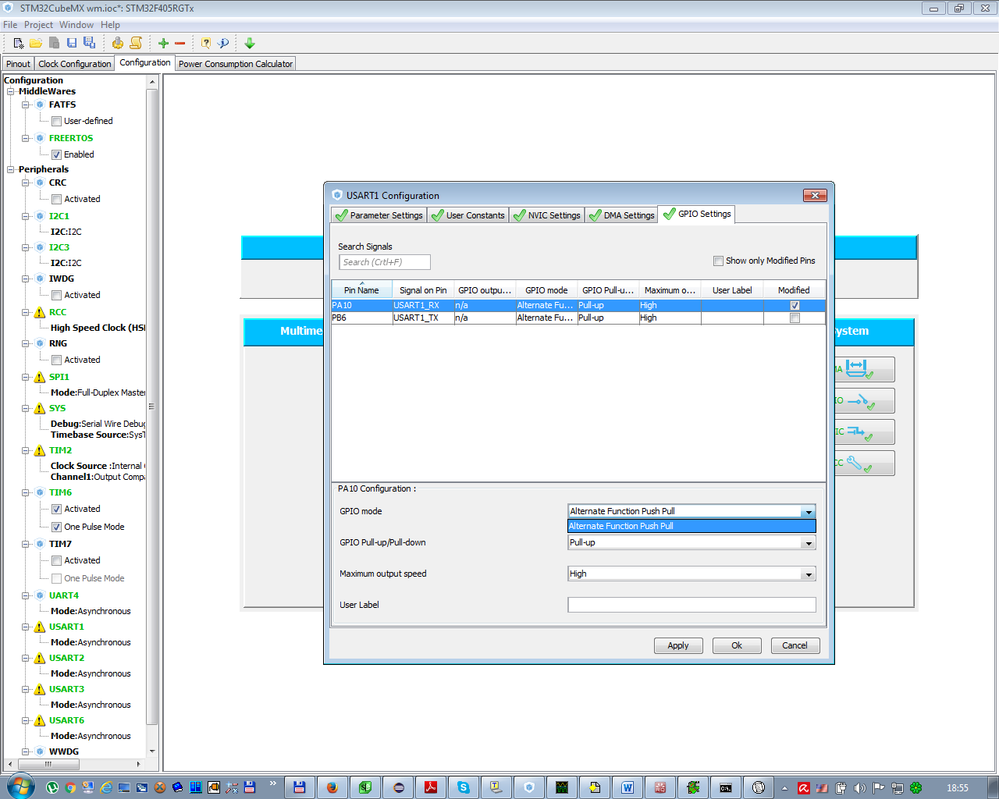

Hi Hannibal,
Could you please check the same on USART1. May be only there the bug is reproduced2016-05-30 9:01 AM

Hi ymenko.sergii,
UART does not operate in an open drain mode, but rather in a push pull. The same with other COM peripherals like SPI. For I2C it is operating on open drain . Maybe there is solution with external components to allow USART I/O operate/emulated as open drain ; you should make you search. -Hannibal-2016-05-31 10:48 AM

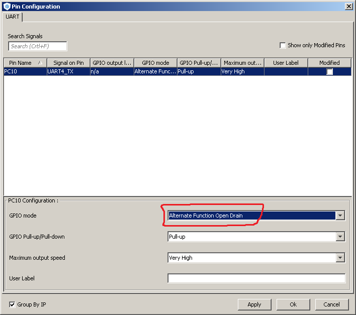

Setting uart/usart as ''single wire (half-dupex)'', tx pin is configured as ''open drain''

Hi klymenko.sergii
As Silva mentionned the open drain is allowed for USART pin only in the case of half duplex to switch between transmit/receive. In case of full duplex, the Push pull is doing the work. -Hannibal-We’re moving the ST Community to a new platform to give you a better and more reliable community experience.
