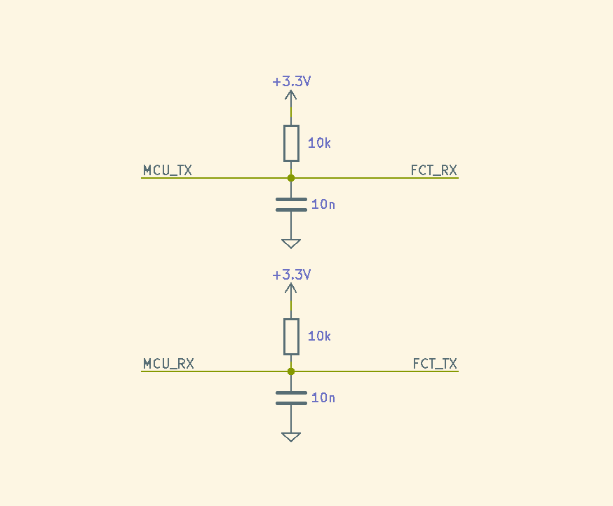

One idea is to use 2 pins which are not needed during FCT, which have a UART port (UART4). However, these pins have pullup resistors and capacitors, due to their normal function. Shown below.

1. its heavy load for a switching pin, but should be no problem, if frequency is not high.

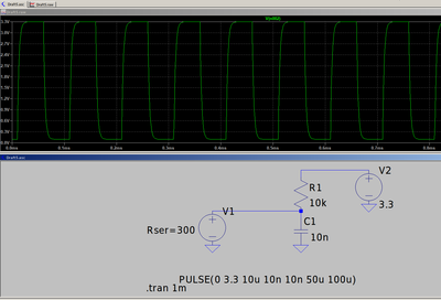

2. i made simple simu :
Here switching at 10kHz in 10n load, source (=pin) has 300 ohms internal resistance ( => 10mA at 3,3V , this a cpu pin can drive....see ds of your cpu); so it should drive 19.2 K easily , if ok for your test, i would set the uart to 9600 .

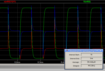

+ checking the average power loss for the cpu/pin :
44 uW should not damage it - right ? :)

So a pin will survive with 20mA*1,3V = 26mW loss, we drive it here at 0,04 mW --> no problem.

I made the same simple simu also with 30 ohms (just to be sure and see what happens then) and it was about 1 mW loss then, still far away from the 1,3*20 = 26mW a pin can safely survive .
