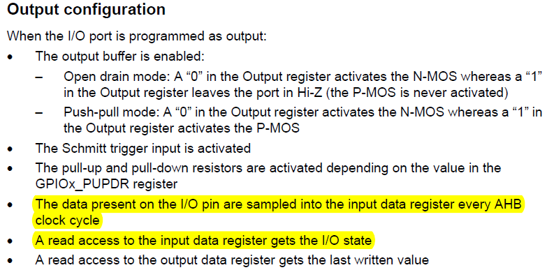

You can use HAL_GPIO_ReadPin().
Even if the pin is set to output the IDR register will give you its current output status.

It is not true. If a pin is configured as open-drain output and its ODR bit value is 1, it may be pulled down externally. Then its IDR bit is 0, but ODR bit still is 1. So, HAL_GPIO_ReadPin will return 0 while output state is 1.
2020-01-16 11:45 PM
Well spotted, @hdmi87 , even if this is a rather old thread, it's always good to correct a mistake.
It appears that there's no function in Cube/HAL to read GPIO_ODR, it appears that the pin-toggling function is the only one which mentions ODR at all.
OTOH, reading back ODR has a relatively rare usage. Cube/HAL, as inevitably every "library" does, implements only a subset of possible functionality, and of course that subset is based on the "most often used" functionality. I'd leave this to simply reading the register.

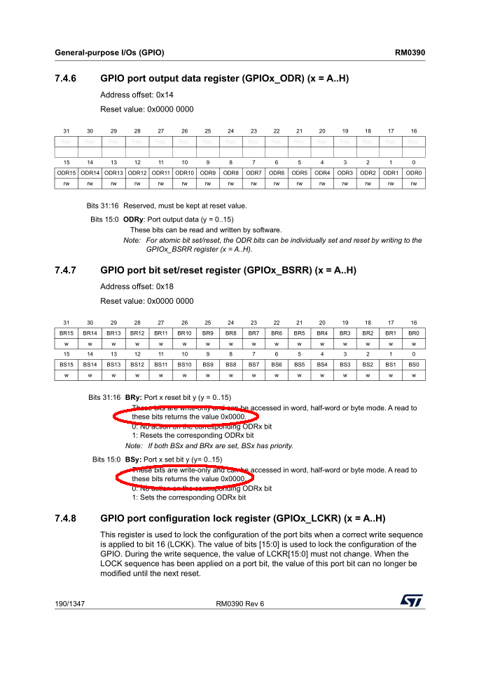

If you just want to read back what you wrote to the pin, you can check whether GPIOx->BSRR is GPIO_PIN_RESET or GPIO_PIN_SET.
2022-08-20 2:07 AM
Have you actually tried this?
GPIOx_BSRR are write-only and read-as-zero.
To find out the state of output register, read, well, the output register, i.e. GPIOx_ODR.
2022-08-20 2:13 AM
I wouldn't answer a 4 year old question with a mind experiment so yes, I've tried it and it works.
2022-08-20 2:30 AM
On which STM32 and how exactly?
2022-08-28 2:02 AM
As the BSRR is a write only register, even if it does read something, it is not guaranteed to be correct. And there ir no sense in doing it anyway, because it doesn't have any advantage over reading the ODR register.
