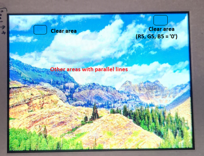

I am going to set up a RGB666 LCD with STN32F779 and Frame buffer in SDRAM. The problem I'm facing is that there are a series of parallel dark lines in the image.
I first tested the SDRAM and the reading and writing is done correctly. Then I realized that only in the R5, G5, B5 data lines of LTDC the signal form is different from the other lines and when I manually write '0' in which these lines, (for example 0b11011100) the image is displayed clear and without problems. Here is an image which there is '1' in R5/G5/B5 on some areas:

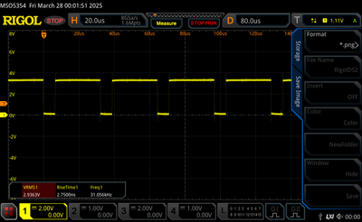

The data waveform for normal data lines like R/G/B-2, R/G/B-3, R/G/B4, ... is as follows:

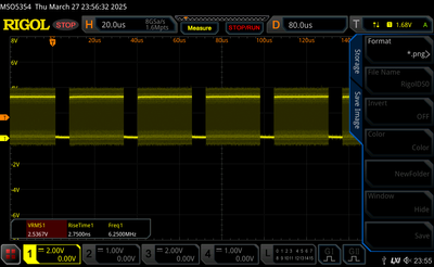

And the corrupted data waveform in the R5, G5, B5 lines is as follows:

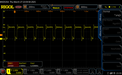

As seen in the photo, there is a 6.25MHz signal inside the main 31.05KHz signal which causes parallel lines in the image and I don't know the reason. The zoomed waveform is as follows:
