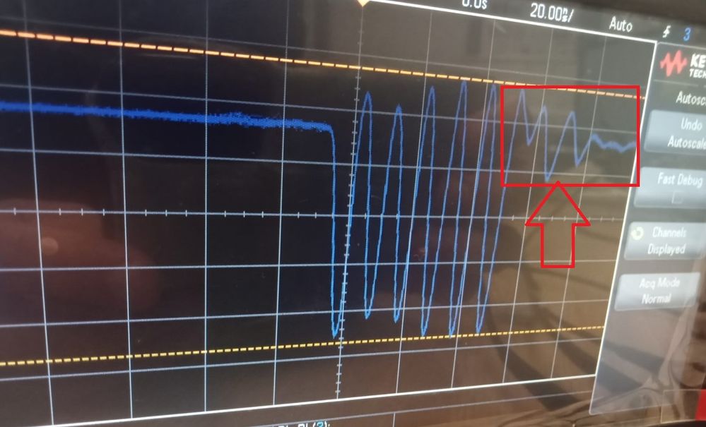

Also, what do you think about fluctuation after the timer is running out?
2024-09-02 3:38 AM
That's no "fluctuation", it's called overshoot.
It's probably due to bad scope-probe setup. For frequencies > 100kHz do NOT use the probe's GND cable, but a spring tip for GND directly attached to the probe's tip.
What's the time scale of that scope pic? Can't really say if it's 20 ms or ns per division. If it's ms, then forget everything above, them you have some other circuit-related problem (load?), or configured the GPIO not correctly.
2024-09-02 7:03 AM
thank you! I measure 100 Mhz
