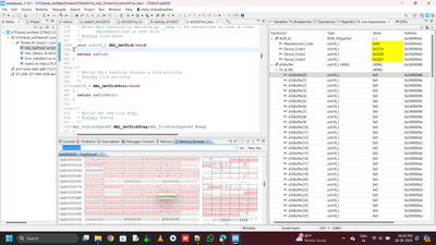

For testing and debugging FMC_norflash(MT28EW01aba) with custom h753 board, I used h743i-eval example as it is for read,write,erase, hence, i could read Manufactring code in memory browser, but in live expression i see address is different, so, where should i check for proper tx and rx data to be match.

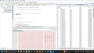

Thank you for guiding me on how to post code. I wanted to provide you with an update. I was able to see the TX buffer and RX buffer data at the address 0x60000000. I believe this indicates that I am successfully writing and reading data from the NOR flash.
I set breakpoints before the erase, write, and read operations. When I reached the erase function, I saw 0xFFFFFFFF, and I observed data in the TX and RX buffers. Could you please confirm if this indicates that the NOR flash is functioning correctly? This is my first time working with NOR flash and FMC, so I want to make sure everything is as expected.

Thank you for your prompt response. When I debug without breakpoints, I don't encounter the "target not responding" error.,shall I confirm that my flash memory can perform read, write, and erase operations successfully, and can be used as a BSP for creating an external loader to store my TouchGFX assets?
Following your guidance from the previous post, I've made these adjustments. How should I proceed from here? Should I keep this same project file for creating loader by including loader.c src.c loader.h and generate Elf.file? Right

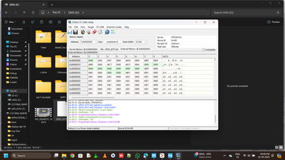

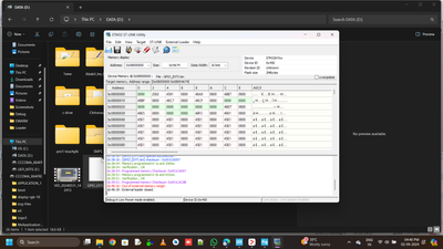

After successfully testing read, write, and erase functions in CubeIDE, I moved forward without following all the steps in EWARM. Instead, I used a similar example( M29W128GH) from GitHub for MT28EW01GABA specifically the FMC_norflash example, which I imported into EWARM. I modified the def.c file according to the memory datasheet, updating the size and page read size from 16MB to 32MB. After building the project, I created a loader that appears to be working correctly. I tested this by programming a bin file of a GPIO example at 0x60000000 and verified its functionality.
Is this the correct approach? Since the loader.c file is similar to my tested application code using the HAL library, should I proceed with this loader to store my TouchGFX images? Additionally, I need guidance on how to implement image data in NOR Flash for TouchGFX. Where should I make the necessary changes to see the results on the display?
If you succeeded with your own loader you can go ahead. Just noticed you are using the old tool STLink-Utility, I suggest to use STM32CubeProgrammer instead. See how you can add your loader in it in this tread.
