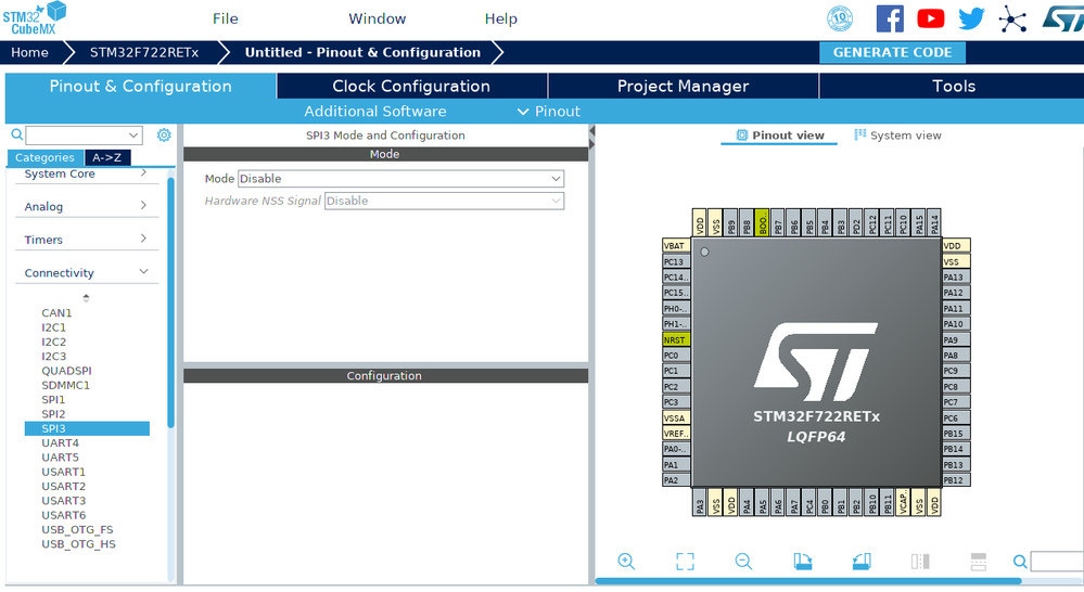

It's possible to control 5 SPI devices with the STM32F722RET6? LQFP-64

You could walk the datasheet and see if you can instantiate 5 separate SPI, or use CubeMX.

So I'm going to use so:
SPI1 for the two sensor mems and two gpio for the CS#
SPI2 for the SPI flash memory
SPI3 for the OSD
