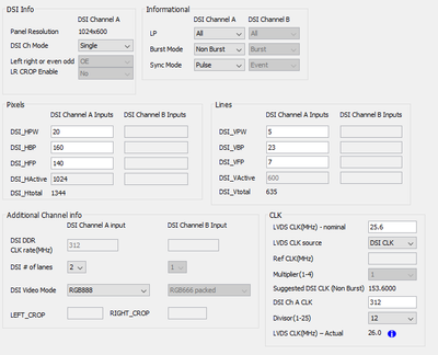

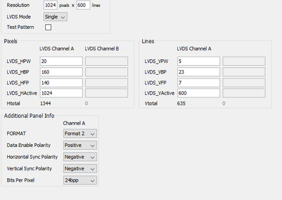

2025-01-20 6:43 PM - edited 2025-01-20 10:18 PM
I'm sorry for no put the parameters, some days ago (in a Texas Instruments forum) read that when you have only SN65DSI83 and want to transmit in video mode should to configure the STM32 in non-burst mode with sync and i did some research so first I was traying with 60Hz but the frecuencies of lanebyteclock of my STM32 no reach to 77,4Mhz. Then I recalibrate the SN65DSI83 (with DSI Turner) to 30Hz. According to my calculations, I set the DSI PHY frecuency at 312Mhz and lanebyteclock at 39Mhz, Video Packet size at 128 Pixels, Number of chuncks at 8 and null packet size at 0.
The parameters of my screen are here:
HSync = 20
HBP = 160
Active Width = 1024
HFP = 140
VSync = 5
VBP = 23
Active Height = 600
VFP = 7
Horizontal Sync Polarity = Active Low
Vertical Sync Polarity = Active Low
Not Data Enable Polarity = Active Low
Pixel Clock Polarity = Normal Input
Here I attach de values that i put in the DSI Turner
So what I'm looking for with the "drawRegion" function is to paint only a 50x50 square in any region of the screen, I set aside a portion of it in 2500 (uint32_t) RAM which I called framebuffer, I don't know if I'm going in the right direction. I didn't work with external RAM, because I only need to paint small regions of the screen, but if any of your recommendations tell me to put one in, then I would redesign the PCB.

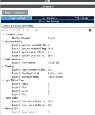

2025-01-23 5:47 PM

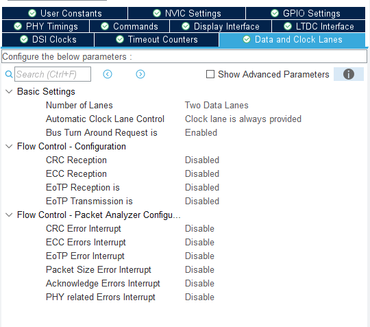

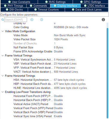

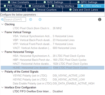

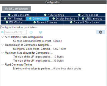

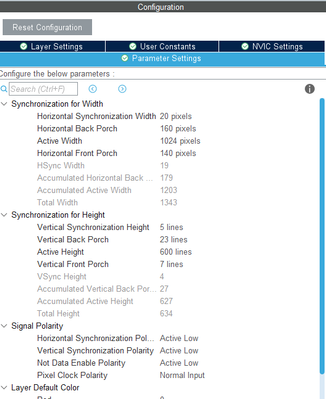

Hi everyone who answered me, I was researching a little and trying with some values in the DSI configuration, so here is the values:
But the result in the screen is not that i hope, the function should paint a rectangle in the screen, in the axe X: 120 pixels (from 0 to 119) and in the axe Y: 30 pixels (from 0 to 29).
Someone can help me to configurate the right values?
(I'm using EK79001 screen and SN65DSI83 from DSI to LVDS at 30Hz).
