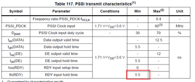

2025-01-23 12:57 AM - edited 2025-01-23 1:01 AM
I'm checking internally if it's the same timing as STM32H7R/S product.
Most probably the issue is on "RDY input hold time" timing (need to check).
From STM32H7S datasheet:

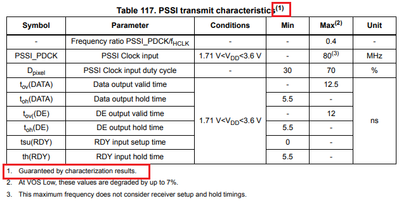

2025-01-24 12:01 AM
@Michal Dudka wrote:
Great. Is this value verified by measurement?
The values are provided by characterization:
