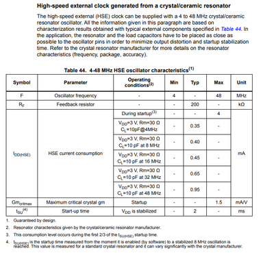

You should also consider the STM32H743 Datasheet which provides the supported oscillator characteristics: frequency range and other critical parameters such as the crystal's gain margin or maximum critical crystal value needed for start-up.
