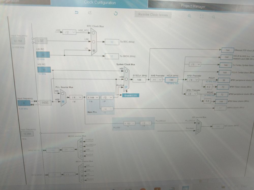

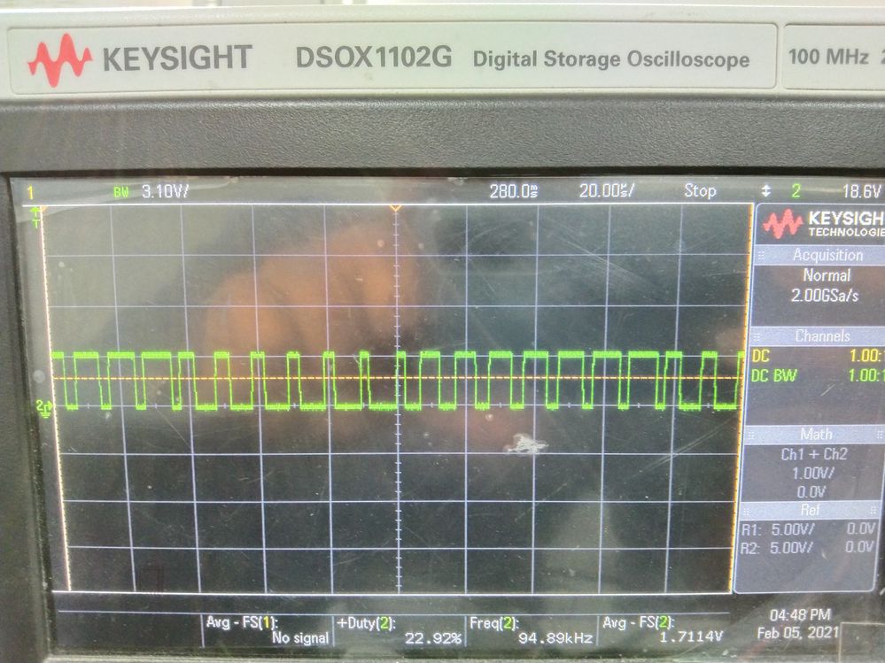

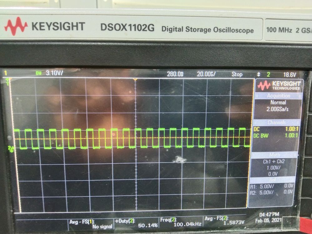

Hello everyone,
I use a STM32F407VET6 MCU board and I'm trying to implement a Timer 8 Interrupt, every 5u sec. In my code, I also use an ADC interrupt, for ADC conversion purposes. I thought that these 2 interrupts are independent. I observed that when I have both interrupts enabled , Timer misses out and no update interrupt is serviced. I even tried involving DMA but didn't yield appropriate result.

I came to the conclusion that " there's a conflict between the ADC interrupts and the timer interrupt when i commented the software command of ADC and toggled the PD11 pin in the callback function. I attached the code , clock config and the waveforms.
Please provide some help!
Thanks a lot, in advance!
Kiran
