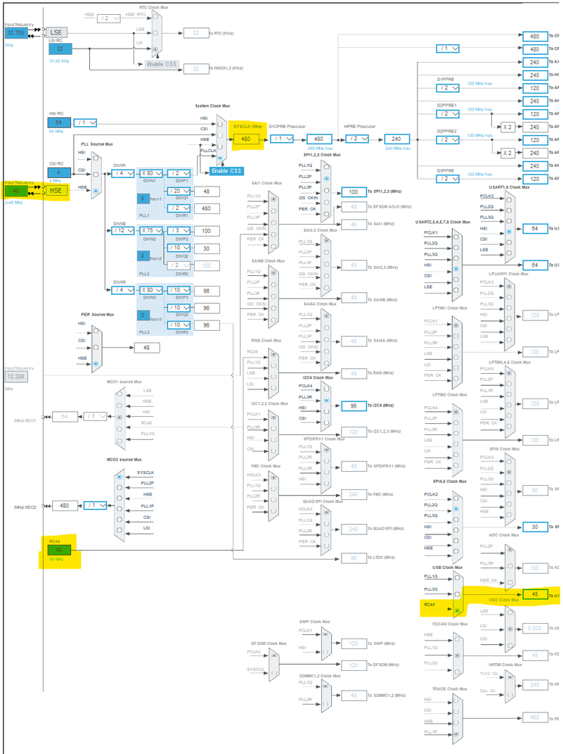

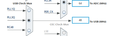

What we don't understand is that the USB clock source is from the "RC48" 48MHz clock, independent from the system clock, which sources the HSE. How does lowering the system clock help resolve this issue? We also tried using HSE to generate the 48MHz for the USB, but the USB just doesn't run.

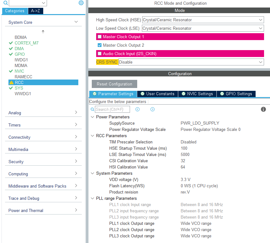

Attached is our clock configuration and .ioc file for your reference.

at first use the HSE->PLL for the USB clock : 48.0 MHz
see my setting, just as example:
Cannot be - if you set the values correct/real : HSE clock;
here set your real frequency:
+ check internal clock at MCO 1 or 2, with scope, should be, what you set:

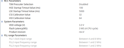

whats strange: your flash wait states at 0 , impossible at xxx MHz core clock, see mine at 200MHz:

RC48 is fine as a clock source for USB device as the peripheral will do clock recovery to ensure a steady clock. Also likely not the problem.

2025-10-28 8:51 AM
hello @Jerry_Hu
I reviewed your IOC file and noticed that the input frequency is set to 48 MHz. Could you confirm whether the HSE clock you are using in your hardware is indeed providing a clean 48 MHz signal?
