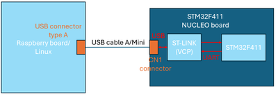

2024-09-18 6:06 AM - edited 2024-09-18 7:15 AM
I think things are mixed up in your mind.
Let me summurize.

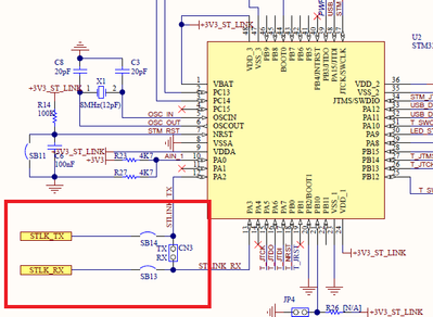

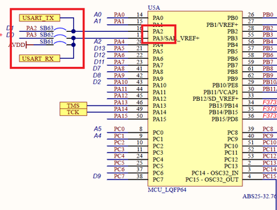

As stated by @Andrew Neil CN1 is the USB connector of the STLINK NOT the USB OTG FS interface of STM32F411 MCU. It's true that STM32F411 has USB OTG interface but not exported on the board. So what you need to use in this case is the UART (see this reply from @Andrew Neil ). It's a regular UART communication Tx/Rx and there is no need for any USB middleware in your case.
These Tx/Rx pins are connected to STLINK that acts as a Virtual Comport.
The Raspberry board will act as a PC. This PC is LINUX OS based.
On Linux, VCP interface is detected automatically as stated by me here and tested by @Andrew Neil here.
So all you need to do is to configure USART2 PA2/PA3 (according to the schematics):
STM32F411 MCU part:
ST-LINK VCP part:
This is a sketch of all of this:
Hope it's more clear now in your mind.
2024-09-18 6:08 AM
@suhfi wrote:okay, we enable the usart connectivity, how do we connect them
The UART connection is carried over the USB link.
@suhfi wrote:but i can say the stm32 nucleo board and raspberry pi 4 has voltage differences
That's all taken care of by the USB link
@suhfi wrote:i dont want jumper pins to be connected.
The default configuration of the Nucleo board is that USART2 of the stm32f411re microcontroller chip is connected to the ST-Link's VCP - you shouldn't need to modify any links.

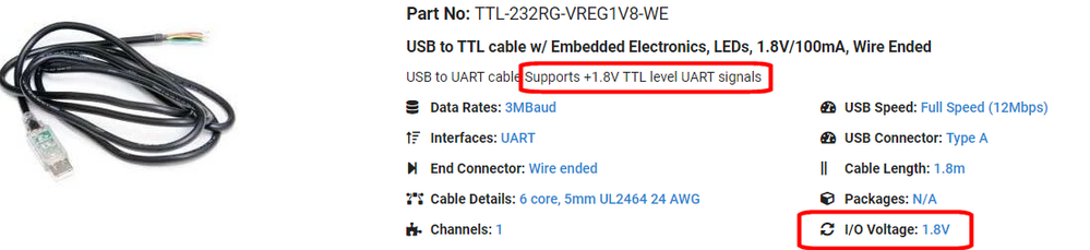

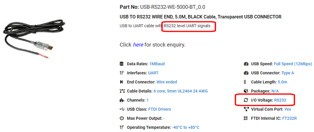

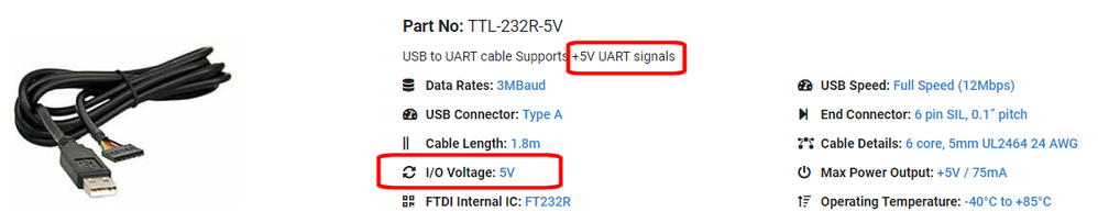

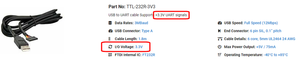

Consider, for example, the well-known FTDI* cables:
They support a whole load of different voltage levels at the UART end, but exactly the same interface at the USB Host end.
So the device at the USB Host end (PC, Raspberry Pi, whatever) is completely oblivious to the voltages used by the UART end.
This is one of the key features of standard interfaces like USB - it means the Host can remain completely ignorant of the internal hardware details (voltages, etc) of the Device.
