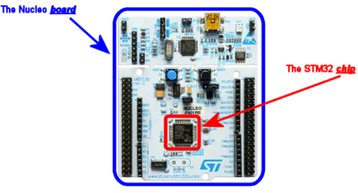

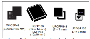

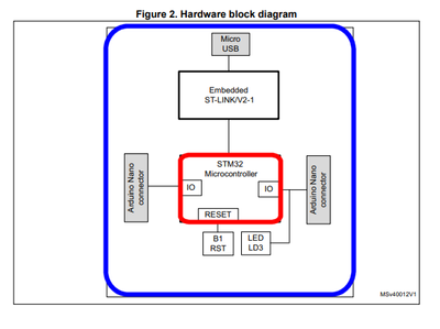

@suhfi wrote:CN1 of stm32f411re. .
Again, stm32f411re is just the MCU chip - it has no CN1.
https://www.st.com/en/microcontrollers-microprocessors/stm32f411re.html
These are chips:
So are you talking about a Nucleo-F411RE board ?
https://www.st.com/en/evaluation-tools/nucleo-f411re.html
To clarify, the chip is highlighted in red; the board in blue:
