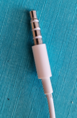

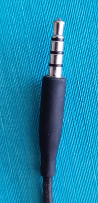

So I'll try if it works. Thank you. I use this headphone jack for samsung (I'm not sure is the CTIA type) for recording :

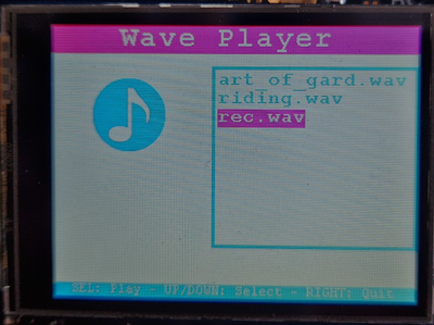

I can hear the examples on the evaluation board (art of gard.wave and riding.wave). But when I select rec.wave to listen to what I recorded and I hear nothing. In the evaluation board, a white earphone is provided in the kit, do you know if it is compatible with the card for recording ?

The later one, white headphone, should be the CTIA type headphone with microphone - as I remember, white join between points is CTIA type headphone.
I suppose the white headphone provided in the kit should support the board demonstration. You may plug it to your mobile phone to check if it can record voice.

The earphone is ok and, really and I think there is no problem with headphones + microphone.

Now I'm sure that both microphone of headphone (white and black) work, I recorded sound (microphone of headphone) with his headphones via VLC+Laptop and it works. So how does the demo program work ? It's not necessary to connect a 1kHz or 2 kHz sine to the microphone, it's not very clean DIY.

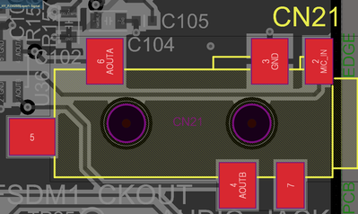

Otherwise, I can connect GBF(+) to PIN 2 of the CN21 connector and GBF (-) to PIN 3 of the CN21 connector.
For a microphone input, I think it is a -60dBV level or 1mV. I'll check if I can get 1mV with my GBF. what do you think ? Is this reasoning correct ?
