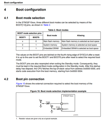

2023-09-08 7:26 AM - edited 2023-09-08 7:27 AM
In your design BOOT1 is floating, internal bootloader cannot works.
Again, you should review your design and refer in AN2586 Chapter 4 Boot Configuration.
To enter in Bootloader (System memory in the Table 2 below) you must apply on pins BOOT0 = 1 (VCC) and BOOT1 = 0 (GND).
BR
Romain,
