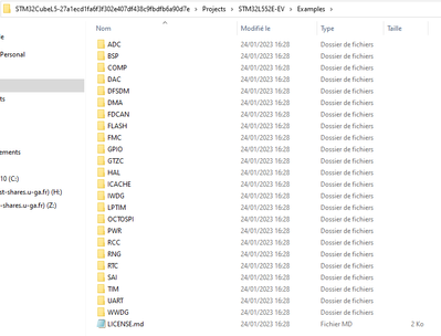

Thank you for your answer, yes I tried the STM32L552E-EV Demonstration, there is no '.ioc' configuration file and how to use the sub-module audio recorder if we don't have the .ioc in the Project ?
Do you have a specific example with code ? I uploaded the project to Github with your link and I don't see the difference with the examples provided by ST ?

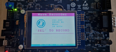

Thank you for this information but after me, It's easier to have the .ioc configuration file than the opposite. Now after downloading the demo project on my card I have this screen and do you know how to proceed for the registration ?
I have this information below, but how to register ? It probably saves on the SD card on the evaluation board ?

I agree with you that it is better to have the .ioc configuration file. but you cannot imagine to see .ioc configuration file for each project of STM32 cube FW package, like the case of STM32L552E-EV/Demonstration.
sorry, I don't understand what you mean "how to proceed for the registration".
STM32L552E-EV/Demonstration readme.txt clearly mentions:
- An audio recorder sub-module provides a complete audio record solution and delivers a high-quality
record experience. It supports record in WAV format at 44.1khz sample rate in mono. The recorded file
rec.wav is saved on the SD card (it is overwritten at each new record).
which means you have to plug a SD card into the SD card slot before you start a recording.

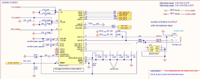

Yes I put in the SD card. I understand that the file is saved on the SD card. But what do we record with? A mic ? A frequency generator ? I'm not sure that the card has a microphone on it,
Do we use the headset microphone to record sound ? And how to play back the sound we recorded ? Can we play back the .wave file directly via the evaluation board ?
2023-08-31 6:40 PM
If I understand correctly, yes, we use the headset microphone to record sound, and play back the sound we recorded to the headset.
NOTE: headphone jack is CTIA type, so CTIA type (instead of OMTP type) headphone with microphone should be used.
