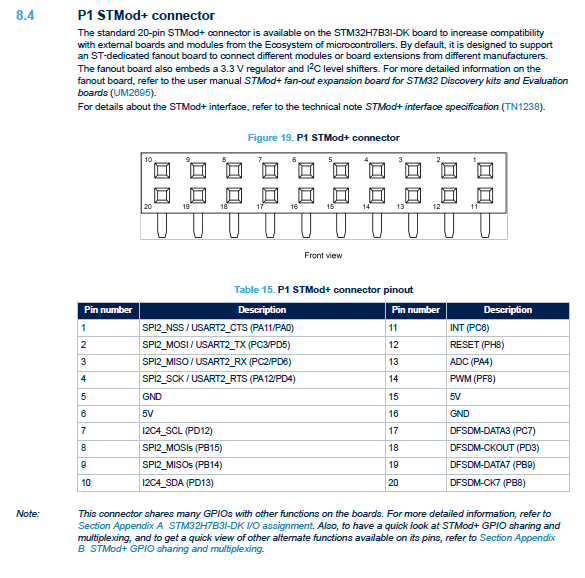

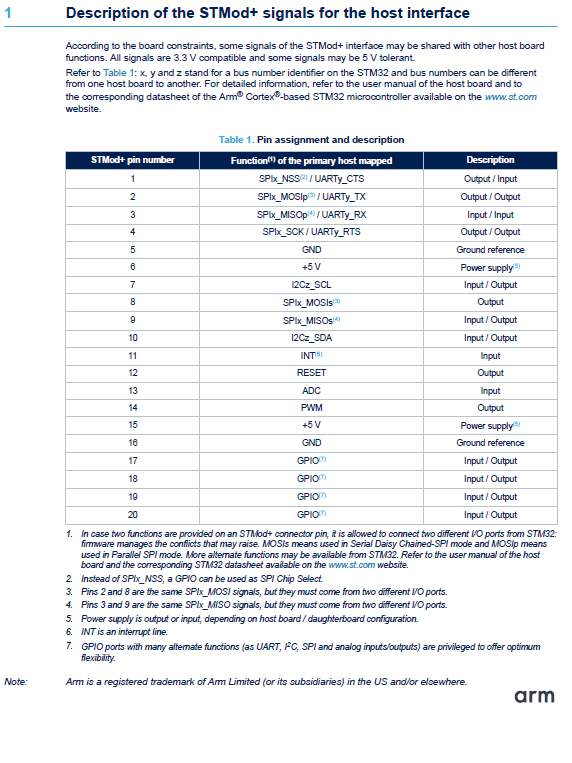

I am trying to connect an SPI communication device and a UART communication device to my STM32H7B3I-DK using the STMod+. From the datasheet for the discovery board, SPI and UART use the same lines (pin numbers 3 and 4) to connect the connections on the STMod+ to the discovery board. But then after reading the datasheet for the STMod+, it says that pins 2 and 8, and pins 3 and 9 are the same? This is where I'm a bit confused. So here are my questions:
I have attached screenshots of the datasheets I'm referring to below. Thank you very much for your help!

The STMod+ pin 1..4 are the prime pins for Usart xor SPI interfaces. Optionally, if the mcu allows and if only simple 2 wire uart is used, uart and spi can be formed with rx tx using pin 2 and 3, while SPI are using pin 1, 4, 8 and 9. The mcu can output the same peripheral signals on different pins. The I2C bus using pin 7 and 10. The connector is 2mm pitch simple mix of PMOD, Click and Seed grove connectors which extend the ecosystem from Arduino on the Fan out board.

Also some newer gen usart IP have RX TX swap functions.
