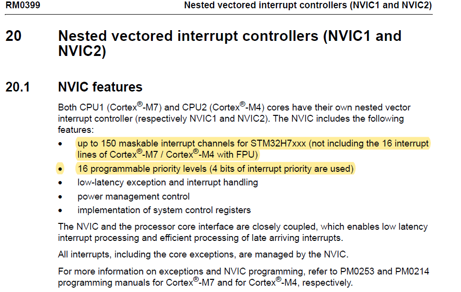

2021-10-18 2:46 AM
Hi @KMand.1
STM32H745ZIT6 provide 16 interrupt priority level or each core but it allow 150 interrupts selection for each core.
Upto 16 line interrupt are designed. So you can use 16 ISR in simultaneously.
