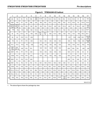

Additionally, I noticed that in the official STM32H750 Nucleo board schematic, some NC (Not Connected) pins are routed either to 3.3V or GND, even though the datasheet specifies these pins as NC. This seems contradictory, and I’d like clarification on whether NC pins must be left unconnected, or if there is a safe routing strategy.
Could the issue with ST-LINK detection be caused by mistakenly connecting NC pins?

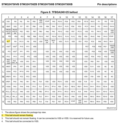

NC pins have specifications on how/if they can be connected. It is different for each of them, see the datasheet for details. In particular, E1 must remain floating and F2+G2 should be grounded. Though clearly these might be optional as the nucleo board leaves them all floating. I'd follow the recommendations in the datasheet.
Probably you will have to redo the board layout.

I’m currently a university student, and I’ve been working on designing both the hardware and firmware for my project. After soldering the MCU, I tried programming it, but unfortunately it's not being detected by the ST-LINK :sad_but_relieved_face:
Also, thank you very much for providing that image it’s a big help. I had been using a different datasheet before, which didn’t contain this level of detail, so this really clarified a lot.
Just one more question: if I ground F2 and G2, and connect F1 to VDD, do you think that would allow the chip to work properly?
Thanks again for your support!

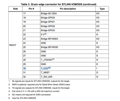

-> ST-LINK shows "Target voltage: 0.0 V"
The ST-LINK has a VTref pin (could be pin 1 of its connector), this should be connected to VDD.
Then the ST-LINK should show "Target voltage: 3.3 V"
Hello, my ST-LINK is the V3MODS version. Does it have a VTref pin? Also, it programs other development boards correctly.
Chris21
Senior III
Appears to be pin 30.
