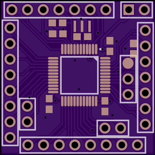

So, I made a F3 breakout board with just the basics on board for prototyping purposes.
Put it all together and have now spent days trying to get the F3 to connect so I can flash it.

STM32F3 breakout board I threw together:2015-12-23 10:36 PM
