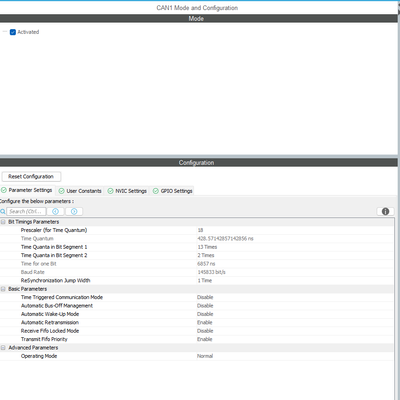

Hi amazing community.
I am working with stm32f429 and cube ide.
This is my configuration for the project
* @brief CAN1 Initialization Function
* None
* @retval None
static void MX_CAN1_Init(void)
/* USER CODE BEGIN CAN1_Init 0 */
/* USER CODE END CAN1_Init 0 */
/* USER CODE BEGIN CAN1_Init 1 */
/* USER CODE END CAN1_Init 1 */
hcan1.Instance = CAN1;
hcan1.Init.Prescaler = 18;
hcan1.Init.Mode = CAN_MODE_NORMAL;
hcan1.Init.SyncJumpWidth = CAN_SJW_1TQ;
hcan1.Init.TimeSeg1 = CAN_BS1_13TQ;
hcan1.Init.TimeSeg2 = CAN_BS2_2TQ;
hcan1.Init.TimeTriggeredMode = DISABLE;
hcan1.Init.AutoBusOff = DISABLE;
hcan1.Init.AutoWakeUp = DISABLE;
hcan1.Init.AutoRetransmission = ENABLE;
hcan1.Init.ReceiveFifoLocked = DISABLE;
hcan1.Init.TransmitFifoPriority = ENABLE;
if (HAL_CAN_Init(&hcan1) != HAL_OK)
Error_Handler();
/* USER CODE BEGIN CAN1_Init 2 */
/* USER CODE END CAN1_Init 2 */

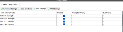

Double check NVIC settings, Vector Table entries, and linkage, the IRQHandler's themselves and that they call back into the HAL subsystem with the correct instance, that in turn calls your call back.

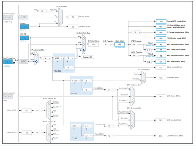

1- From the screenshot it seems you’re using an old version of CubeMx tool. Could you please tell which version you have?

1 -Cube mx version is 6.9.2

1 -Cube mx version is 6.9.2: an old version but it's OK

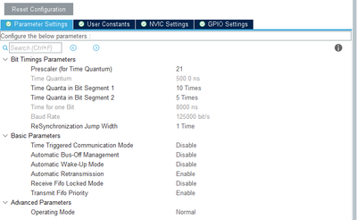

Hi SofLit .. I checked again the cube configuration ..
and numbers are ok for 125 kbit/s
hcan1.Init.Prescaler = 21;
hcan1.Init.TimeSeg1 = CAN_BS1_10TQ;
hcan1.Init.TimeSeg2 = CAN_BS2_5TQ;
Error_Handler();
ma still not enter inside here transmitting at 125 kbitS

if (HAL_CAN_ActivateNotification(&hcan1, CAN_IT_RX_FIFO0_MSG_PENDING | CAN_IT_TX_MAILBOX_EMPTY | CAN_IT_RX_FIFO0_FULL | CAN_IT_ERROR | CAN_IT_BUSOFF | CAN_IT_ERROR_PASSIVE | CAN_IT_ERROR_WARNING | CAN_IT_LAST_ERROR_CODE) != HAL_OK)
printf_err("HAL_CAN_ActivateNotification: FAIL\r\n");
Any ideas ?
