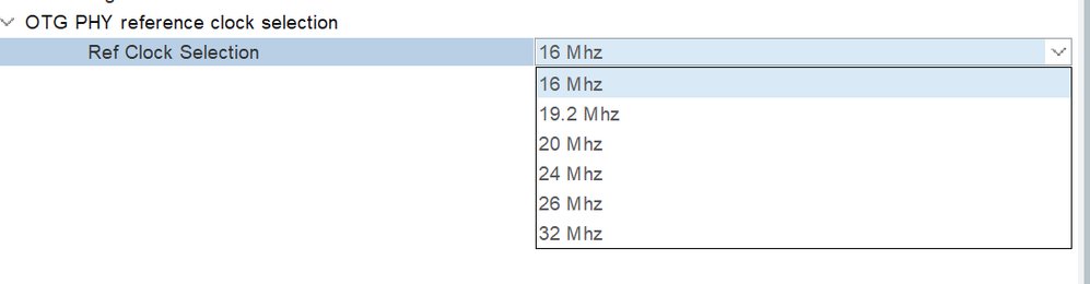

I'm trying to work with USB on STM32U595ZJT6Q (with SMPS)
Ref Clock Selection under USB_OTG_HS is set to 16MHz
OTS HS Clock Mux is set to HSE (the board has 16MHz crystal)
CubeMX 6.11
STM32Cube_FW_U5_V1.5.0

2024-04-13 1:55 PM
Okay, I think I figured it out. SYSCLK has to be more than 48MHz. Just changing it to 64 MHz fixed an issue.
