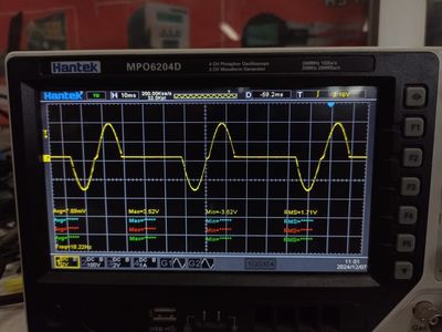

I generated a sinusoidal signal through the DAC using DMA. I understand that DMA performs looping since I use circular mode. In short, I want to control the numbers generated by the DMA. So, when the signal changes to DC (the array contains only 2048 or hold_samples and hold_samples2), it will immediately be detected by my program using the function:
deteksisinyal(void)
However, I have NOT yet figured out how to control the numbers/results/shape of the generated signal in terms of code. I want to control the signal changes, namely from peak - flat - valley - flat. I will use the flat part for another function, specifically to detect changes in a device. Please, I need help from experts with examples or guidance on what I should do. I will include my code below. Please provide feedback or ask questions about my code.

and the shape of the signal is as follows: and the shape of the signal is as follows:
Is it possible? I need your help.
