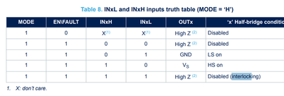

just from ds STSPIN830 :
So driving shoot-through is prevented by chip design.

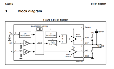

btw >suggest anyway, any solution from ST
https://www.st.com/resource/en/datasheet/l6385e.pdf
L6385 has independent hi/lo side drivers.

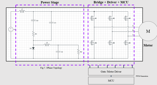

So the idea is as below circuit diagram
In this topology, the shoot-through interval is deliberately introduced as a control mode. During this interval, both the upper and lower devices of a phase leg are turned ON for a very short duration, while the current rise is limited by the input inductors and the DC-link energy storage network.
From my understanding, IHM16M1 provides six independent PWM inputs to the gate driver stage but has interlocking protection is there and as per your previous answer it cannot be override.
But us their other boards (Especially eval boards) Which can support my requirements?
L6385 has independent hi/lo side drivers. yes, it does I think it is discontinued.

Ok, i see.... What should it do better than all the existing "standard" inverters (with deadtime) ?
