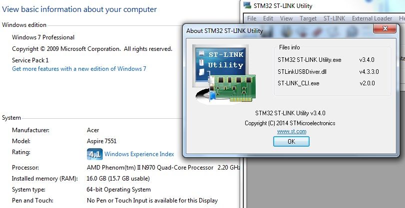

May be you can have your IT people come poke it?
AV is the primary cause for installation failures. Also make sure you actually unpack the ZIP to a non Desktop directory (ie a real one), and run it from there. You could also try from a different user, in case your user space is snarled up. This is a mirror of the v3.4 I have installed on my Win7 laptophttps://drive.google.com/file/d/0B7OY5pub_GfIOHBCNnlJZlBhcTQ/view?usp=sharing
