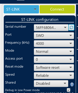

2025-11-08 11:40 PM
In ST-Link settings, reduce the SWD clock frequency to about 1 MHz and see if it helps.
2025-11-09 4:37 AM
try with your old st-linkV2 again, settings: normal , software reset:
Just power your H7 board from the st-link, connect: swd, swc, 5V, GND .
(connect these 4 wires first, then plug the st-link to the usb !)
Then connect...
