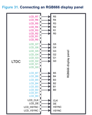

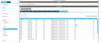

Hello, I want to use LTDC on the STM32H743VIT6 microcontroller, but when I enable this peripheral in CUBEMX, it does not activate correctly. For example, the pins for B are from B3-B7, while they should be from B0-B4, and the same goes for R, G.
