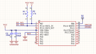

Schematic of my MCU wiring:

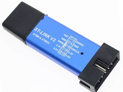

First, stsw-link004 is obsolete. So, please make sure to use the STM32CubeProgrammer last version (V2.18.0).
Also, could you please share a picture of your ST-Link. It may be a Clone. More details on this article: How to recognize a genuine ST-LINK/V2 versus a clo... - STMicroelectronics Community

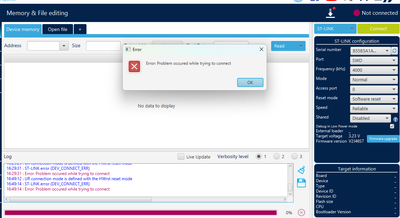

2025-02-03 7:47 AM - edited 2025-02-03 7:53 AM
in CubeProgrammer:
set mode: normal
+ reset: software reset
-- then try again + show result.
put a cap (100nF) on rst to GND !
2025-02-03 7:49 AM
Seems to be the same error.
2025-02-03 7:50 AM
I don't have access to an original one, the one I have access to is this:
2025-02-03 7:54 AM
Unfortunately, we can't guarantee anything about a Clone ST-Link. So, I suggest you command a new genuine one if you are looking for good working performance.

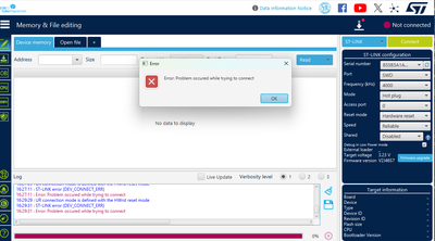

2025-02-03 7:56 AM
But still pic shows hw reset:
on CPU: put a cap (100nF) on rst to GND !!!!!!!
