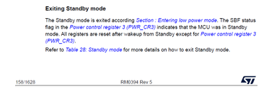

The link on the bottom of page 158 is bad.

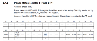

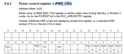

There is no SBF flag in PWR_CR3, actually it is in PWR_SR1.

Hello @PSzab.1
Thank you so much for reporting this typo. I've escalated for correction on the coming release of the document (under internal ticket number 202258).
