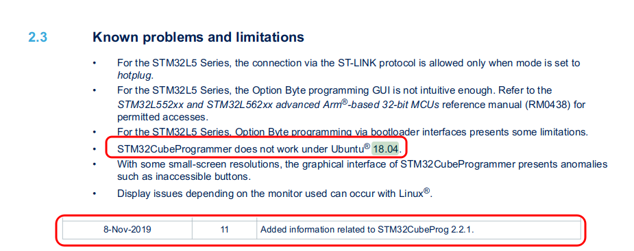

don't waste your time...its a "know limitation" .... STM32Cube programmer don't work on ubuntu 18.04.

SOLUTION for Ubuntu 18.04 CURRENT 22 Feb 2020: The detail advice is provided in ST's USER MANUAL for the Programmer, which is here:
Relevant instructions for Ubuntu 18.04 are:
To get STM32CubeProgrammer working with Ubuntu ® 18.04
1. Install OpenJDK 8
a) sudo apt install openjdk-8-jre-headless
2. Set OpenJDK 8 as your default Java Runtime Engine
a) sudo update-alternatives --config java
3. Install OpenJFX
a) sudo apt purge openjfx
b) sudo apt install openjfx=8u161-b12-1ubuntu2 libopenjfx-jni=8u161-b12-1ubuntu2
libopenjfx-java=8u161-b12-1ubuntu2
c) sudo apt-mark hold openjfx libopenjfx-jni libopenjfx-java
To install the STM32CubeProgrammer tool, you need to download and extract the zip
package and execute SetupSTM32CubeProgrammer-vx.y.z.linux, which guides you through the installation process.
I've just done this on Ubuntu 18.04 on an i5 and it works fine now.
(And I remember now this was what I had to do a few months back on the desktop mentioned above).
Good luck all.
2020-02-23 2:36 PM
I tried your way but that didn't work for me. Solved : see my update above -- I find the instructions from the User Manual work fine:
