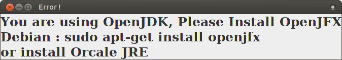

2019-06-22 12:22 AM
I have some problems with launch CubeProg from Ubuntu.
$ ./STM32CubeProgrammer
/usr/local/STMicroelectronics/STM32CubeProgrammer/bin/STM32CubeProgrammerLauncher
JavaFX NOT installed => warn user
But openjfx installed:
$ dpkg -l | grep openjfx
ii libopenjfx-java 11.0.2+1-1~18.04.2 all JavaFX/OpenJFX - Rich client application platform for Java (Java libraries)
ii libopenjfx-jni 11.0.2+1-1~18.04.2 amd64 JavaFX/OpenJFX - Rich client application platform for Java (native libraries)
ii openjfx 11.0.2+1-1~18.04.2 amd64 JavaFX/OpenJFX - Rich client application platform for Java
ii openjfx-source 11.0.2+1-1~18.04.2 all JavaFX/OpenJFX - Rich client application platform for Java (sources)
$ update-java-alternatives -l
java-1.11.0-openjdk-amd64 1111 /usr/lib/jvm/java-1.11.0-openjdk-amd64
Please any help!
2019-06-22 1:04 AM
SOLVED.
Need doungrade jdk & jfx
# apt install apt install openjdk-8-jdk openjfx=8u161-b12-1ubuntu2 libopenjfx-java=8u161-b12-1ubuntu2 libopenjfx-jni=8u161-b12-1ubuntu2
than
# update-alternatives --config java
and set java-8-openjdk
And hold the version:
echo "openjfx hold"|dpkg --set-selections ; echo "libopenjfx-java hold"|dpkg --set-selections ; \
echo "libopenjfx-jni hold"|dpkg --set-selections ; echo "openjfx-source hold"|dpkg --set-selections
