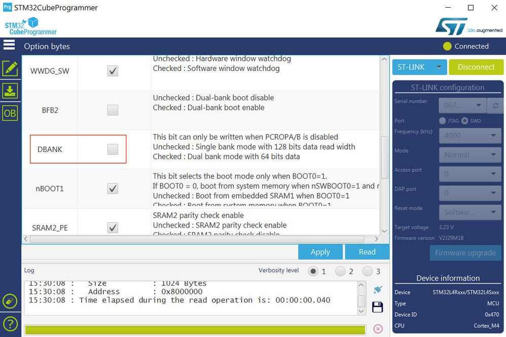

For anyone who don't uses the KEIL IDE: You can use the STM Cube Programmer to disable the DBANK flag in the Option Byte region of the processor like this:

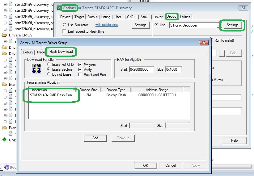

On the STM32L4R9-DISCO it was necessary to select the 'Dual Bank' variant of the Flash Algorithm for Keil to program the board. There should be two 2MB algorithms, pick the one you're currently not using.

Hallo Clive, its probably a totally stupid question to a pro user, but where can i find that option? Keil Help doest give results, The output of google is Zero. Only searching for Flash algorithm brings me to
http://www.keil.com/support/man/docs/uv4/uv4_fl_flash_algorithms.htm
which tells nothing but leads me to a folder where .FLM files are.
And in Keil the 'options for Target xxxxxx' is totally confusing for ARM beginners.
Could you please point me to that option?
2018-01-17 7:57 AM
Thank you Clive One, that was the solution and very helpfull.
2018-04-05 8:27 AM
Thanks, this is the correct solution in order to use Atollic True Studio with STML4+
Another Solution with activated FLAG would be to do a full chip erase via ST Link Utility every time a debug session with TS is started.
