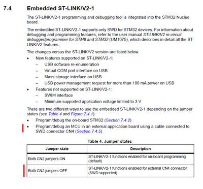

Hello @ParkPork and welcome to the ST community,
Yes it's possible to use that onboard ST-LINK to connect to an external MCU. You can refer to the user manual of the board: UM1724 STM32 Nucleo-64 boards (MB1136)
Section 7.4 Embedded ST-LINK/V2-1:
