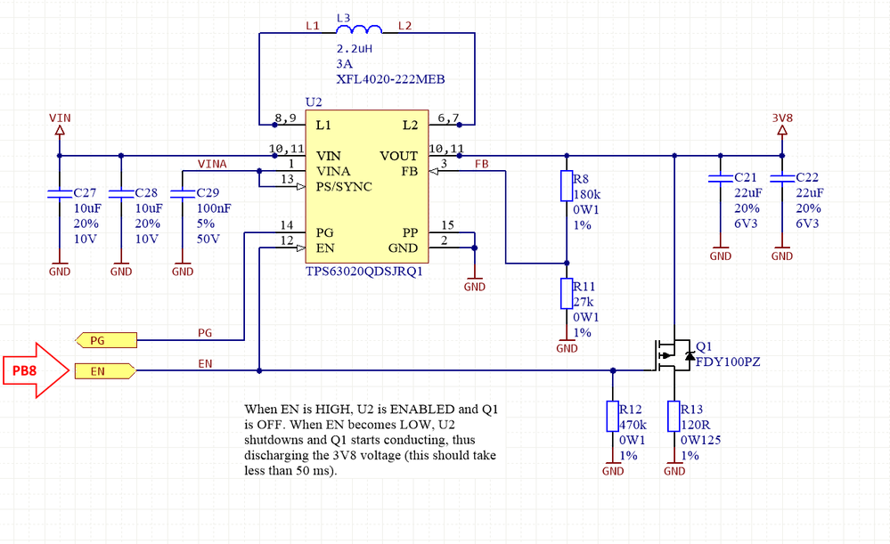

I am experiencing some unexpected behavior then... Please take a look at this schematics:
The EN port is connected to the MCU's PB8 pin (no code in MCU).
In general when EN is pulled HIGH, the Q1 transistor should turn off and U2 should go ON. When pulled low, Q1 goes ON discharging the 3V8 voltage and U2 shutdowns.
My problem is that when I test this circuit I get voltage spikes on EN line, thus, U2 is constantly turned ON/OFF/ON/OFF. You can hear the conductor switching. I started to add capacitance to EN line (between EN and GND). First 100 nF, the spikes became smoother. Then I added 1 uF and spikes no longer occured but the voltage at EN pin was not what I expected: 2.3 V (Mcu is powered from 3.3 V). So even though there is a pulldown on EN line, its state is 2.3 V. Nothing else is connected to this line, so this voltage level has to be forced from the MCU PB8 line...
I experienced similar problems in the past with F4 chips and reset line. I had to use diode because it seems like at startup the reset pin becomes an output for a moment. I dont know if this situation is something common.
What do you think?
Edit: removing the R12 resistor (it was 100k, not 470k) from EN line gives 3.259 V on it (MCU is powered from 3.299 V). Replace R12 with 10k, and EN voltage becomes 0.7 V. This means there is some series resistance on PB8 pin, am I correct? What is this state?

Sorry, I typed it wrong:
At startup the EN has to be held low to turn off the converter and turn ON the Q1, so it is discharging any voltage present on the converter output.

Thanks for answer,
I could not find any notes about the EN pin being pulled up in the TPS6320 datasheet. It says there that it cannot be left floating, so I think there is no internall pull up.
As for the note you have mentioned, I am not sure how this reffers to my problem. I think the input voltage of the converter shouldnt have anything to do with EN functionality.
I havent tried disconnecting the PB8 pin. I will do that now and let you know, thanks.
2018-04-05 3:09 AM
I think I found it, R12 should be a pullup resistor, to shut the FET off when EN is Tristate.
at start up make the PB8 PIN High to Enable U2
pull PB8 low and power will go off momentarily.
