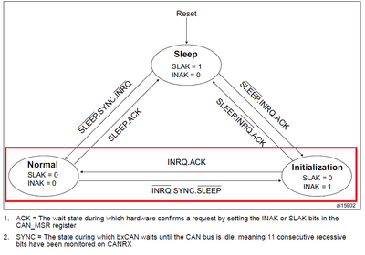

To go from Normal mode to init mode or vice versa you need to check this figure in the reference manual:
Your node needs to detect 11 consecutive recessive bits on the bus otherwise it keeps blocked mainly if the bus is overloaded.
