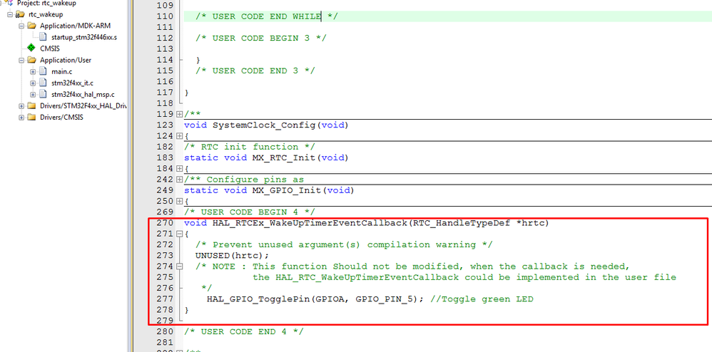

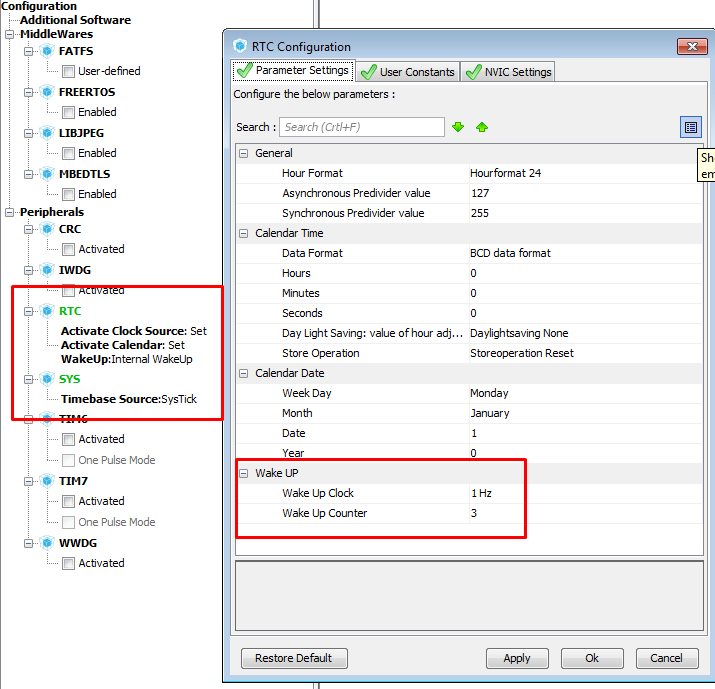

I have configured the wakeup Timer with CubeMx:
For 3 Seconds:
In the main.c File I added and using the Wakeup-Callback function:
