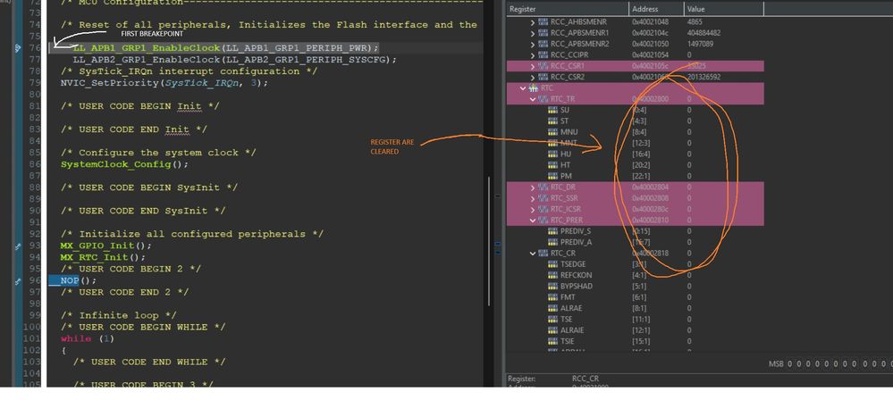

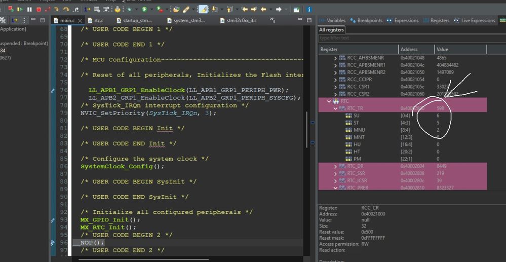

First photo, RTC start and counting:
Second photo, immediately after PIN RESET ( register are cleared, counting is stopped and start from beginning):
Before first brake-point, register are cleared( I didn't even call MX_RTC_init):
So, could you check, what happend and why I cann't achive continues counting after RESET or what I should set (bit register, other things)?

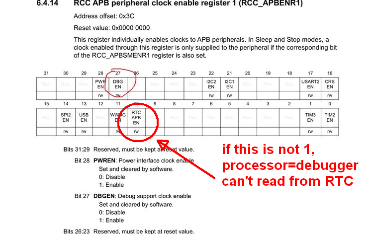

2026-03-13 2:30 AM - edited 2026-03-13 2:31 AM
When inserting code, use the </> icon from the top of editor pane. The Moderator told you so in your initial post.
The 'C0 implements the RCC_APBENR1.RTCAPBEN bit, disabling the APB interface after reset, so you won't be able to read the RTC registers in debugger until that bit is set. You can set it in debugger, too.

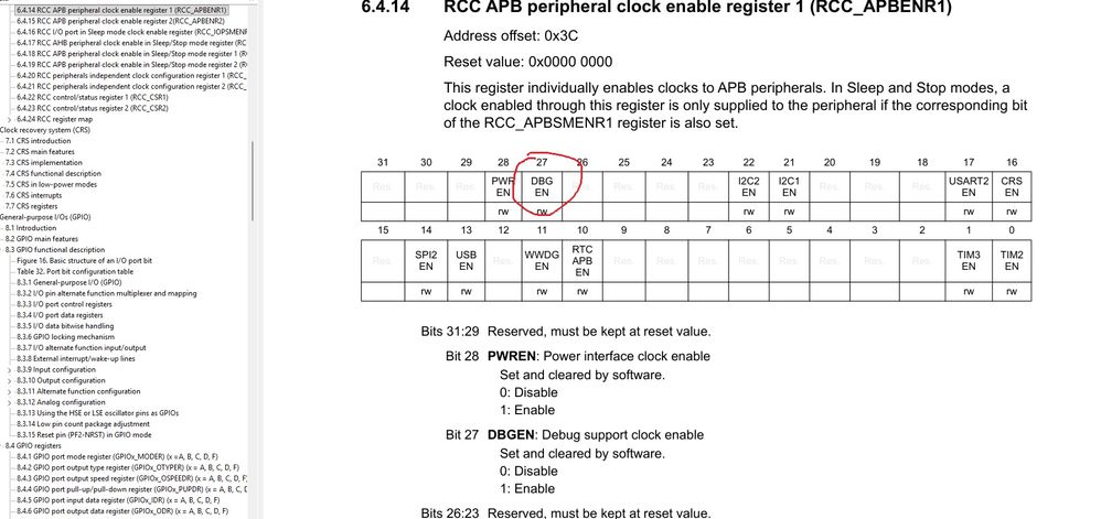

@waclawek.jan I'm not following you. Look at picture:
Are talking about this register and bit DBG EN should be set?
In referance manual for STM32_C031 is a bit unclear on this, so I'm looking for some clarification from your side.

After setting this bit the debugger should be able to display content of RTC registers (you may need to refresh somehow the display, I don't use the debugger you do so don't know), thus judge whether time is already changed or not. If not, step/run to next breakpoint, until it does.

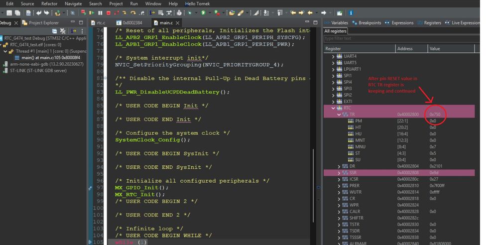

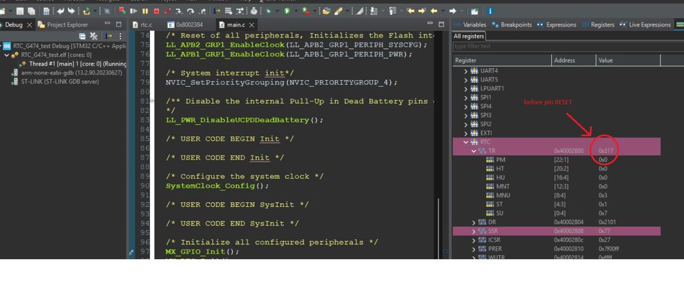

I tested also STM32G474, and the RTC domain behavior as expacted, the counting of time is continued, look at picture 1:
time in RTC-.TR register:
after pin RESET
picture 2, after pin RESET, the value in RTC is keeping and counting is continued
So, you on STM32G474 works fine after pin RESET but if in STM32C031 not working (acuuracy is enough for me), I don't what to you external device like DS3231.

Have you tried to set RCC_APBENR1.RTCAPBEN bit in the 'C0 in debugger, at the first breakpoint, to be able to observe the RTC registers?
