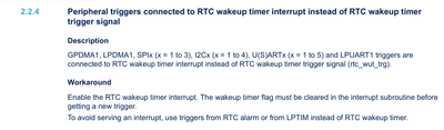

Errata said I must disable WUTF because I use GDMA1. STM32U575xx and STM32U585xx device errata - Errata sheet
void RTC_IRQHandler(void)
/* USER CODE BEGIN RTC_IRQn 0 */
SET_BIT(RTC->CR, RTC_CR_WUTE);
SET_BIT(RTC->SCR, RTC_SCR_CWUTF); // See https://www.st.com/resource/en/errata_sheet/es0499-stm32u575xx-and-stm32u585xx-device-errata-stmicroelectronics.pdf (Section 2.2.4)
/* USER CODE END RTC_IRQn 0 */
HAL_RTC_AlarmIRQHandler(&hrtc);
/* USER CODE BEGIN RTC_IRQn 1 */
/* USER CODE END RTC_IRQn 1 */

Hi @Saket_Om , as mentioned in the errata file, some peripherals will trigger RTC wake up timer. Indeed, it happens with me so I need switch to RTC alarm trigger. But somehow, it did not work...
