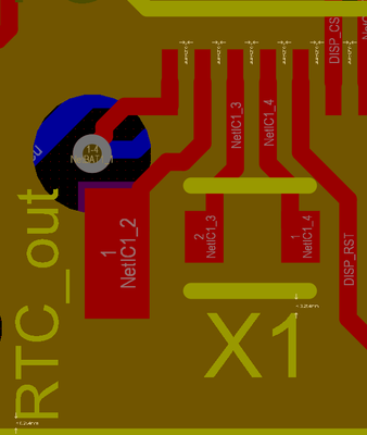

a insight of the pcb layout for the X1 rtc crystal.

Where are the load capacitors for the crystal?

Hello Peter,
the device is genuine. I have a stock of them from a uk distribuitor, bought some years ago.
Concerning the layout, there are no aditional layers conected to the crystal. Underneath the top layer there is only a solid GND layer.
What concerns me is Robk1 remark regarding the external capacitors wich i have not considered in the design, i am not sure if these are mandatory.
I will study the AN2867 document aswell.
I will try to port the SW to another board using the same mcu, and this one has footprints for the crystal capacitors.
I will come back with details
2026-01-08 2:46 AM
I am back with good news, after added the load capacitors on the crystal the ppm value improved significantly
Using 4.3pf on the crystal, i measure 512.045 hz
Using 8pf i measure 511.95hz
I will study in detail AN2867 until i find a suitable value for the load capacitors.
Thank you.
