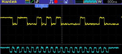

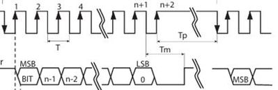

Here are the 20-bit signals I’m trying to read.
If I attempt to read two 10-bit words (or two 16-bit words), does the SPI receiver need a Tp microsecond separation between words?
2025-01-15 10:44 PM
I’ve tried reading a pair of 16-bit words and a pair of 10-bit words and the data never lines up with what I’m seeing on the scope.

Your scope screenshot looks OK to me (where it does "never lines up"? SPI mode 0 and it looks OK to me).
No idea what you want to connect (as external slave). But based on the waveform you have provided:
- your external chip wans to see a Tp (a "pause" on the clock), in order to realize a "new transaction" (CMD).
sure, if you do not pause, your external chip might be confused. So, make sure after 10bits sent you provide Tp.
Other then this - I do not see any issue.
