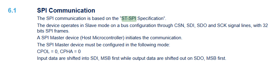

I am using STM32L475 board and trying to communicate with VNF1048F by SPI. The communication protocol which is used is defined as ST-SPI. On STM32 I can configure at maximum 16 bit communication but the device (VNF1048F) requires 32-bit frames. That is why I am using 8 * 4 bit. On regular basis I spi error bit is getting set, but only when reading certain registers.

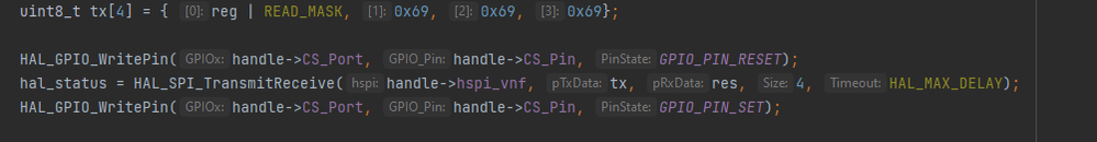

I am doing as you suggested using 8 bit mode. Currently, I am using the HAL library for transfer as can be seen below:

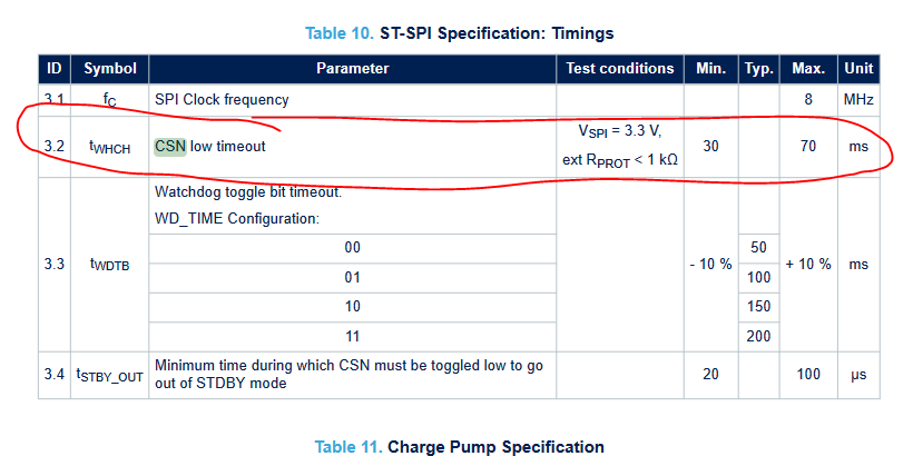

Also maybe anyone know what CSN low timeout does mean?
