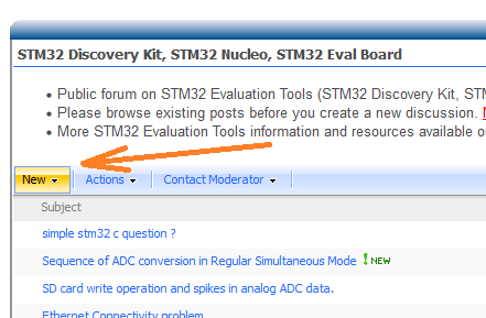

Sorry for this interrupt.i am new in this forum.i don't know how to post my doubts.pls help me.
