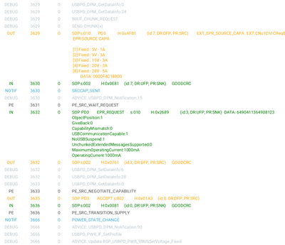

1st PDO in EPR mode ACCEPT:

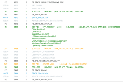

2nd PDO REJECT:
How can I debug these things inside the stack? What am I missing?

2026-01-31 12:28 AM
After creating a topic, I found my bad in USBPD_PWR_IF_SearchRequestedPDO while in EPR mode.

2026-02-02 7:12 AM
Hi @xGloooM
To create EPR request STM32 as source:
Initialize EPR PDOs properly by creating your EPR Source PDO PORT0_PDO_ListEPRSRC following the USB PD3.1 (or 3.2 depending on your stack, as of now I guess we support only 3.1) AVS PDO format (voltage in 25 mV units, current in 50 mA units).
Assign this PORT0_PDO_ListEPRSRC and its count to the EPR PDO storage in USBPD_PWR_IF_Init.
Enable EPR Source support in DPM_Settings for the port to inform the PE and stack .Is_EPR_Supported_src=USBPD_TRUE,
Ensure USBPD_PWR_IF_GetPortPDOs supports USBPD_CORE_DATATYPE_SRC_PDO_EPR to handle PDO retrieval for EPR.
In USBPD_PWR_IF_SearchRequestedPDO, check if the requested RDO position corresponds to an EPR PDO.
In USBPD_PWR_IF_SetProfile, set voltage/current to process the selected PDO type when the device receives a power contract request RDO to handle EPR voltages and currents properly (up to ~48 V).
