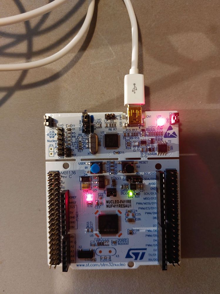

2023-11-18 11:49 AM
I'd also like to note that even upon first plugging in, LED1 is flashing red, LED2 is constant Red and LD2 flashes green

2023-11-18 12:13 PM
Can you share a picture of your board.

2023-11-18 4:03 PM - edited 2023-11-18 4:59 PM
Not connecting is strongly indicative that this is a charging cable (power only), and provides no data connectivity.
Try a cable that is known to work with peripherals, or sold as such.
2023-11-18 4:36 PM
Thanks Tesla, I think you may be right, this may not be a charge and sync cable. I'll have a look around and see if i can test it somewhere else!
