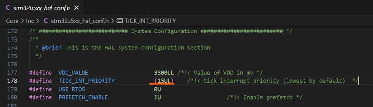

> Where/how do I modify current HAL_GetTick() timer priority in CubeMX?
You do this in stm...hal_conf.h, exactly as on your picture. If the Cube gets in your way when it re-generates the code, fight back and revert undesired changes.
