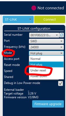

Where can I find that ,,connect under reset" button in the stm32cubeprogrammer? I saw this recommendation in other similar threads but could not really find that one in the programmer... As far as I understand from the datasheet, the BOOT0 must be pulled high during the programming, or am I wrong?

The connect under reset setting is in the Mode settings, but it's unlikely to help anything in this case.
