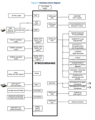

Looking for Part numbers for modules on the B-U585I-IOT02A dev kit, specifically the Bluetooth and WiFi modules, but also looking for part numbers on the modules listed below. Didn't see P/N's listed in the datasheet but maybe I was looking in the wrong place:
-Bluetooth Module
-WiFi Module
-2 digital microphones
-Relative humidity and temperature sensor
-3-axis magnetometer
-3D accelerometer and 3D gyroscope
-Pressure sensor, 260-1260 hPa absolute digital output barometer

Hello @PNada.3 ,
Which B-U585I-IOT02A revision are you using?
You can find all references module for B-U585I-IOT02A Discovery kit in UM2839 and precisely Figure 2. Hardware block diagram.
Note that, this board have many revisions such as "U585AI-D01", "U585AI1-D01" and "U585I-C02", for that please take a look to 10.2 B-U585I-IOT02A product history in the same user manual and check the product change description.
Also, you can find directly the references module number by checking the schematic pack.
I hope this answer your question.

Awesome thanks this is what I was looking for!
