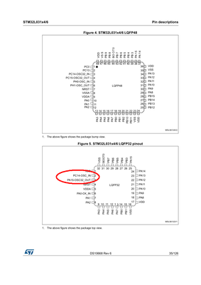

STM32L031 LQFP32 pinout is wrong
Both pins 2 and 3 are incorrectly described:pin 2 is PC14-OSC32_INpin 3 is PC15-OSC32_OUTMaybe other 'L0xx DS are affected, too; I did not check.JW
