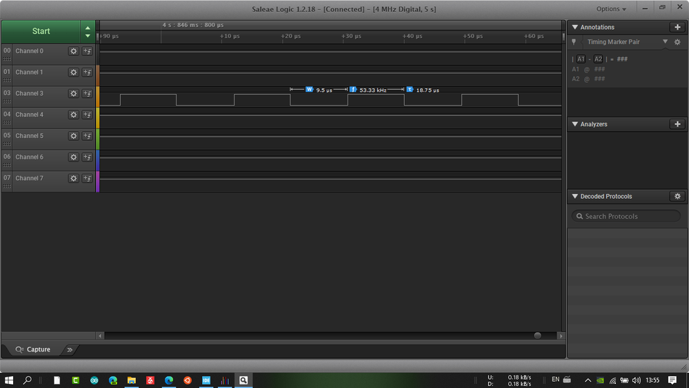

So using the above formula and concept I should get a delay of 1sec when counter register overflow(while(!(TIM2->SR & TIM_SR_UIF));
But that is not happening in the real case, my led is not blinking at all. When I check with the logic analyzer then also it shows this.
I am not getting exactly where I am wrong, whether in the formula part?? or in configuring Timer ??? or My system clock configuration.
I am really stuck on this for the past 2-3 days, not getting any clear idea, will be waiting for valuable and insightful suggestions
